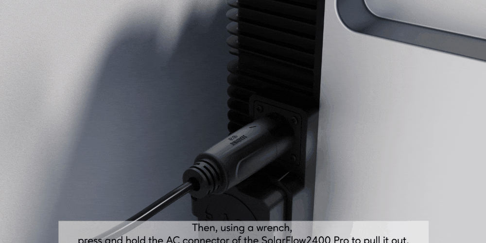

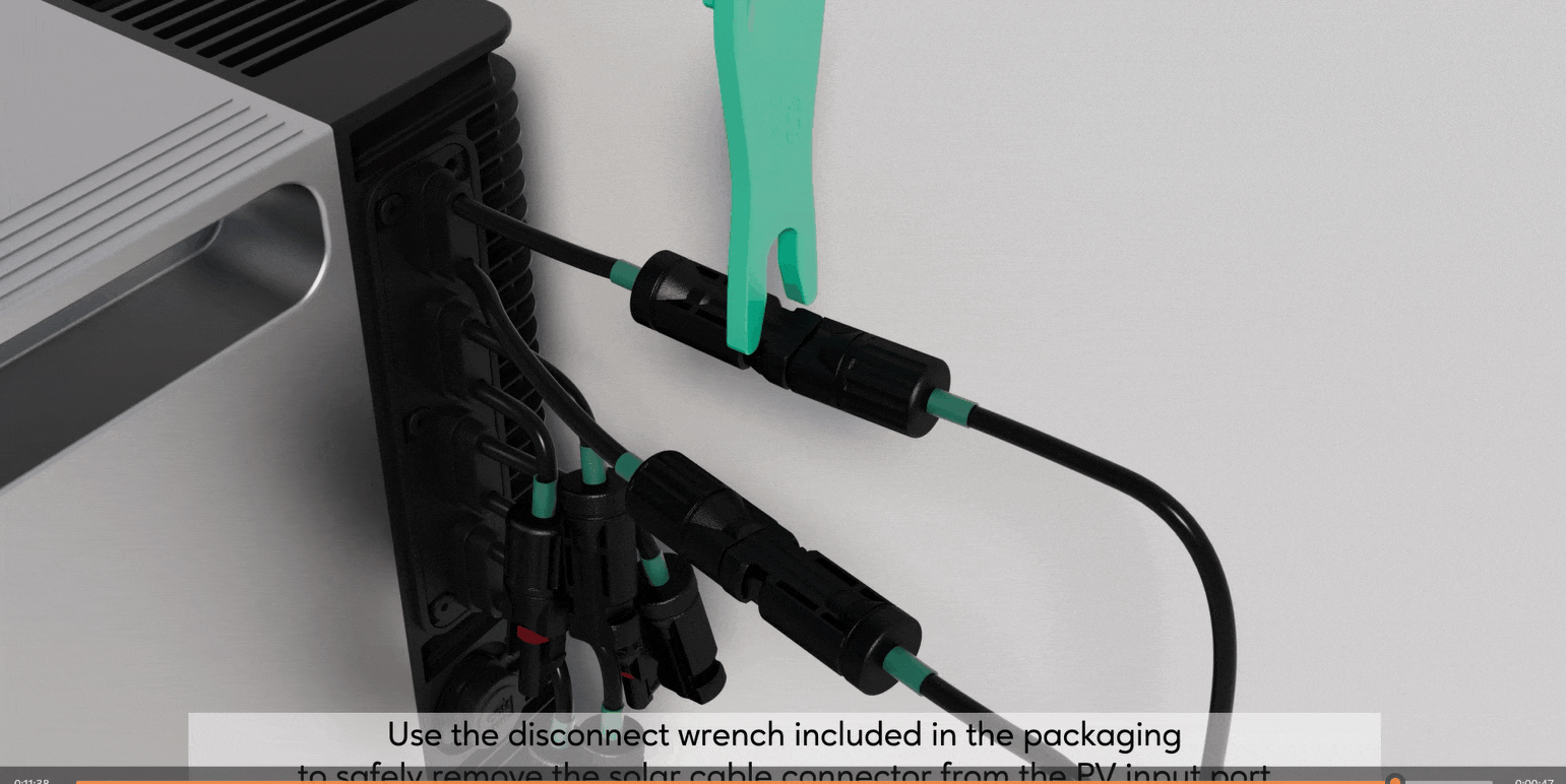

Environmental Condition: Perform removal in dry conditions to prevent water ingress into open ports.
Required Tool: Ensure the proprietary disconnection wrench (included in the original package) is available for releasing MC4-compatible solar connectors.
Protective Gear: While the system is "Plug and Play," insulating gloves are recommended when handling cables connected to active circuits.
