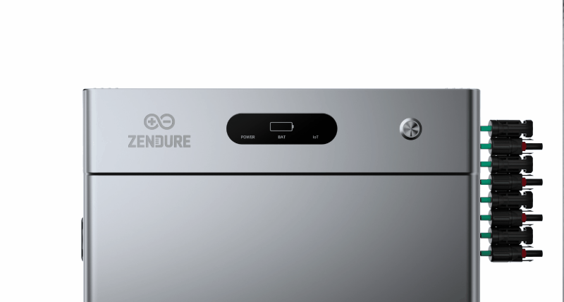

The SolarFlow 2400 Pro automates energy routing to balance generation, storage, and consumption based on real-time data.
PS: AC Coupling: Compatible with existing balcony power stations up to 1800W AC input.
AI-driven scheduling based on real-time Time-of-Use (TOU) pricing.

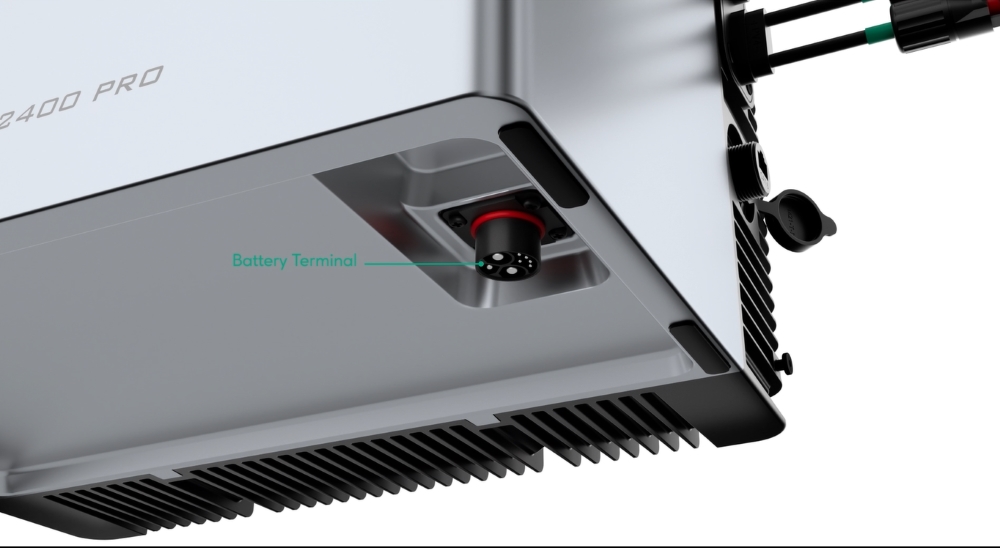

Battery Terminal: Port for connecting add-on batteries to the system.
Antenna: Wireless communication antenna for system connectivity.

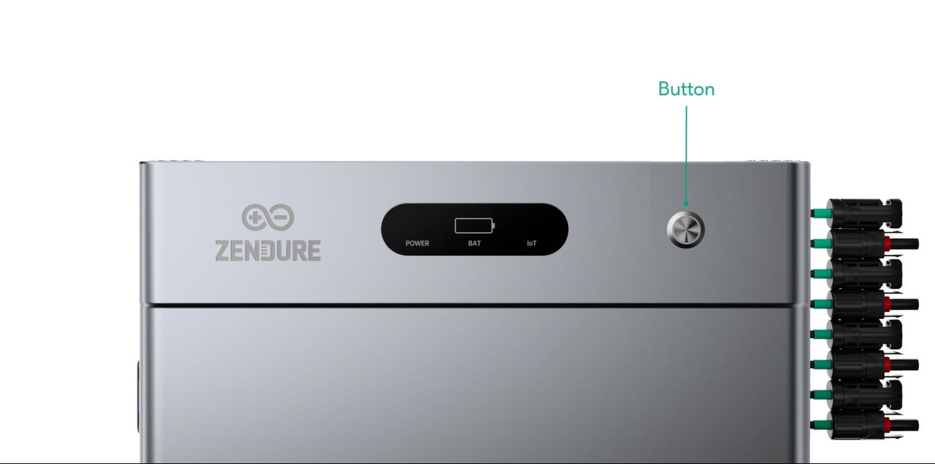

Button: Front control button for system controls.
LED Light Strip: LED indicators for battery status, power, and IoT connectivity.
