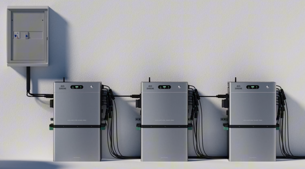

| Wiring diagram the distribution box | Display | Please note | |
| Single Unit | ![]() |
1. Each SolarFlow 2400 Pro unit has a rated power of 2400 W. 2. Check the main incoming capacity of the distribution box and calculate the total existing load. Then determine the remaining available capacity of the electrical system. Make sure the available capacity exceeds 2400 W to guarantee safe operation. |
| Multiple Units | ![]() |
1. Each SolarFlow 2400 Pro unit has a rated power of 2400 W. 2. Check the main incoming capacity of the distribution box and calculate the total existing load. Then determine the remaining available capacity of the electrical system. Make sure the available capacity exceeds 2400 W to guarantee safe operation. 3. Make sure the total available system capacity exceeds 2400W x N, N is the number of SolarFlow 2400 Pro units to be installed. A safety redundancy should be reserved to ensure stable operation. |

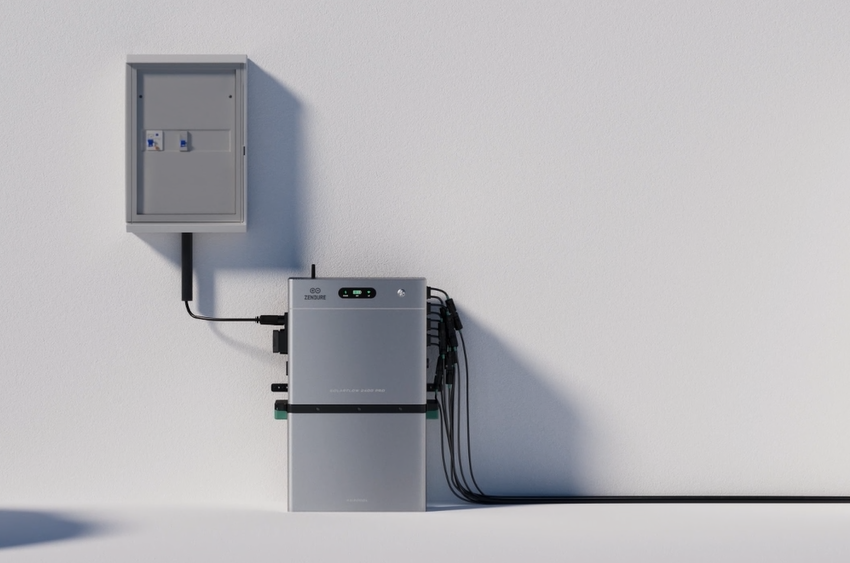

| Single Unit | / | ![]() |
1. Each SolarFlow 2400 Pro unit has a rated power of 2400 W. 2. Check the main incoming capacity of the distribution panel and sum up the current load to determine the total available capacity. Make sure the available capacity exceeds 2400 W to guarantee safe operation. 3. Additionally, check the available capacity of each individual phase and install the SolarFlow 2400 Pro on a phase where the available capacity exceeds 2400 W. |

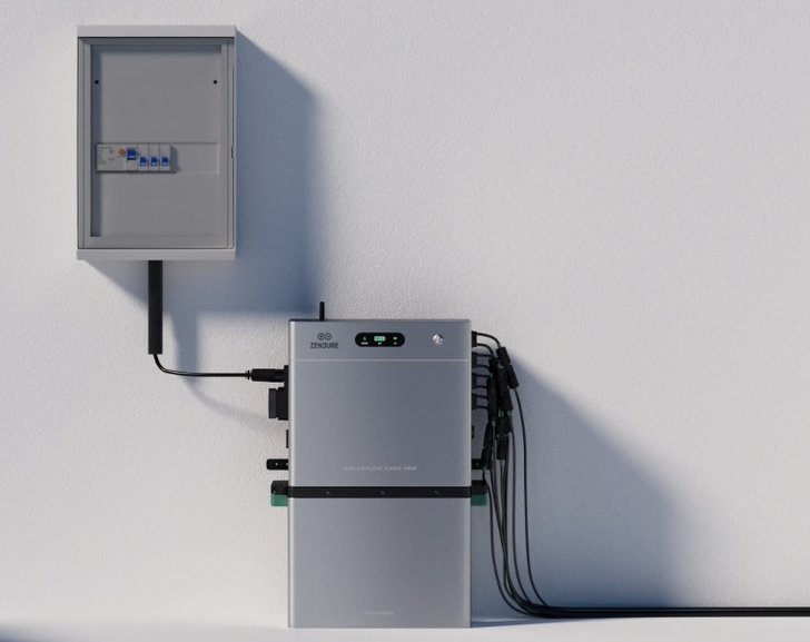

| Multiple Units | ![]() Metodo 1: Connect each circuit breaker to one of the three phases (L1, L2, and L3) from the main three-phase breaker, achieving a balanced distribution across all three phases. |
1. Each SolarFlow 2400 Pro unit has a rated power of 2400W. 2. Check the main incoming capacity of the distribution box and sum up the existing loads to calculate the available system capacity. Make sure the total available system capacity exceeds 2400W x N (where N is the number of SolarFlow 2400 Pro units to be installed). 3. Check the remaining available capacity on each phase and identify those which exceed 2400W. 4. Always install the SolarFlow 2400 Pro on the phase with the highest available capacity to ensure safe and stable operation. |

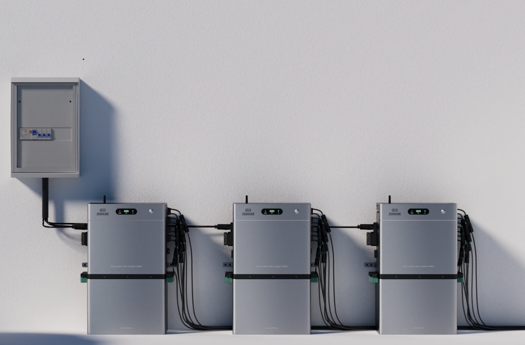

![]() Metodo 2: This setup is suitable when phase L1 has ample capacity, L2 has moderate capacity, and L3 has little or no remaining capacity. |
![]() Metodo 3: This method is suitable when only phase L1 has sufficient remaining capacity. |
