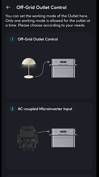

Supplies power to household appliances directly from the stored battery energy. This is intended for essential equipment during blackouts or for independent power needs in a garden setting.
Allows the connection of an external inverter to charge the SolarFlow 1600 AC+ batteries via AC. This is useful for integrating existing third-party power stations into the Zendure ecosystem.
